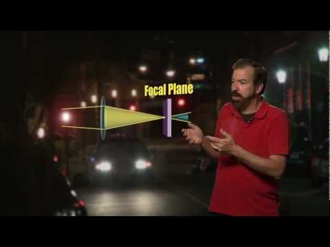

ThatNikonGuy clearly explains it here =
However my thought experiment using the same camera and switching from FX to DX is even simpler.
