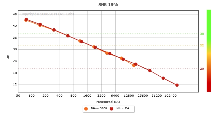

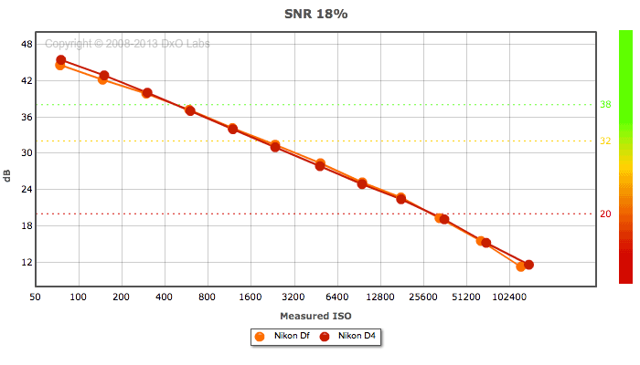

    You are correct. In fact, DxO publishes normalized figures for this exact reason. The normalized ISO performance of the D800 is virtually identical to the D4 up to ISO 12,800.
    The D800 also has higher normalized color depth and dynamic range compared to the D4.

    @tc88
    Thank you for providing the correct information Ade.

  • tc88tc88 Posts: 537Member
    Ade, thanks for the confirmation. I would not be able to find the graph myself on dxomark.
    Sorry but "Normalized" is a cool-aid term and is anything but that and is pure BS. DxO rapidly released that when Canon was screaming at DxO when the D3/D700, D90, and every other Nikon trounced their models. It is a hypothetical equalizer that reduces images to 8mp image. Basically it turns the readings into JPEG basic files and compares those. And what happens then? Every sensor receives basically the same score within 10% of the base, so none look much better than another, and Dx0 gets manufactures off their back. This is how the D800 magically becomes equal to low light to the D4. Sorry, love my D800, but it is not close to the D4 in low light. When sensors jumped over 20-22mp mark, DxO's test went really wonky posting inflated scores.
    Basically all the arguments people want to use are based on the output of the sensor. Why in the world would you take the output, play and mold it into something it is not. I re-size D800 files every day, It doesn't reduce noise, it smashes it together and makes a bigger blob that may or may not be closer to the color it was suppose to read. Noise around eyebrows (i.e. loss of detail) doesn't magically become better when you re-size, it just becomes a less techno-color blob. And when you crop? Oh yeah DxO "print" doesn't account for that at all - that can work both ways. The "Screen" results give a much better and real world result. The "Normalized" is there to keep companies off their backs, and consumers happy by making them think their sensor isn't much different from another one.
    If you believe it is correct to take every sensor, and re-size them to 8mp and effectively remove 8-28mp of output of data? Then all you really need is to help Nikon with it's compact digi cam sales and skip the DSLRs.

    The fact remains, when you downsample an image, the noise disappears. Comparing the D800 at 36mp to the D4 at 16mp isn't as fair as seeing what the 36 downsampled to 16 looks like; else, why don't we see how good the 16mp files looks upsampled to 36?
    The fact remains that this camera will be shot at 1600 - 12,800, and the D800's blobs downsized still are blobs.
    @TaoTeJared: The images cannot be the same when they are downsized, yet the noice remains and the D4 is superior. I think you have to make up your mind :)
    Normalization does not remove image data. Normalization combines image data. One cannot make a coherent argument without understanding this difference.
    There is no difference Ade. Combining data removes data. Consider the following:

    jshickele, your understanding is quite wrong. I think Ade is going to vomit reading it. :)
    Note the word Ade used is combine, not add.

    Yes, your math is wrong. If your logic is correct, then combining enough pixels of mid tone values will give a white out picture.
    I will explain later why down sampling improves SNR if no one else has done by then. Got to go for now. :)
    Thanks, this technical area is quite fascinating and I look forward to it.

    It's really not hard to understand. I will literally try to explain this with elementary school math.
    Suppose we want to take a picture of a uniform wall, with a tonal value of "10" (for super easy math).
    First, we try a 1-pixel camera, which (due to noise) registered 11. The pixel noise error is 1 out of 10, or 10%.
    Second, we try a quadruple resolution, 4-pixel camera. Due to noise, the camera registered [7, 12, 8, 9] for its four pixels. Compared to the actual value of 10, our 4-pixel camera made absolute-value errors of [3, 2, 2, 1] for each respective pixel. So, the average pixel noise error is (3 + 2 + 2 +1) / 4 = 2 out of 10, or 20%.
    At this point, we might conclude that our 4-pixel camera is "noisier" because its average pixel noise error is 20%, compared to 10% of the 1-pixel camera.
    But, we realize, if noise is truly a random process, then over time it tends to average itself out. That is, some noise will produce results which are too low (like [7, 8, 9]) while other noise will produce results which are too high (like [12]).
    So let's try combining our 4-pixels into 1-pixel by using the averaging function: (7+12+8+9)/4 = 9. The error after averaging is now is 1 out of 10, or 10%.
    Therefore, even though our 4-pixel camera had more per-pixel noise (20%), it actually has the same 1-pixel performance as our 1-pixel camera (10%).
    I hope you can see that combining data (via the averaging function in this case) is very different from removing data. If we had simply removed data from our 4-pixel array [7, 12, 8, 9] to arrive at a 1-pixel solution, then on average our error would have remained at 20%.
    With slightly more difficult math (involving logarithms), we can mathematically show that this result can be extended to the normalization of arbitrary megapixels. So whether we are talking about 1-pixel cameras, or 8mp, or 24mp, or 100mp, the same concepts apply.
    But you have removed the data in the original 4 pixels by combining them into one with the average function. Sure you have kept the noise down, but the nose and eyes are now missing and we are left with what TTJ described as a blob (I exaggerate to illustrate the point). I don't have my D800 set to combine pixels (well, I shoot Raw plus Fine JPEG, so unless you count that, I am not aware of a setting that does this).
    The combining (done by averaging) seems to be removing data by reducing the resolution.
    Am I missing something?
    Realize that both hypothetical cameras ended up at a baseline 1-pixel resolution and with the same noise level of 10%. One does not have more details ("nose and eyes") than the other. It's a fallacy to think otherwise.
    Instead of 1-pixel, we can arbitrarily pick any other pixel count baseline (more below).
    You (perhaps unknowingly) combine pixels every time you view an image at less than 100% crop; every time you email or post an image at other than original size; and every time you print. I.e., your image processing software automatically performs this combining for you, using various algorithms (which may or may not be more better than simple averaging, from a noise perspective).
    For example, if you print an image on a 8"x12" paper (20cm by 30cm), with a printer resolution of 300 dpi, then you are really printing an 8.64 MP image (8 * 300 * 12 * 300). Since you have a D800, all that 36 MP goodness will be combined to produce a less-noisy 8.64 MP print, behind the scenes.
    This is exactly why, by the way, DxO picked a normalization baseline of 8.64 MP. But they could have as easily picked another baseline without changing the basic results.
    We've strayed quite a bit from discussing the Nikon Df so I think I'll leave it here.

    Yes, no more to be said. Ade, thanks for your efforts. Your last explanation was something that I understood but I now understand your thinking, reasoning and perspective, so thanks.

    The reason why in practice that theoretical model fails is because the 4 Pixel's total surface area of sensitivity is less than that of the 1 pixel because you lose light at the borders of the pixel ie the inter pixel spaces do not have light sensitivity. Thus the s/n ratio is less even when you do "sum" it back into 1 pixel. so the larger pixels always win if the resolution is sufficient. (assuming all else being equal)
    edited November 2013
    heartyfisher, the border is really a very small area. So in theory, what you said may be true, but in practice, the effect may not be significant. :)
    But the proof is in the normalized data. If one sensor indeed has better efficiency, let's say a sensor made five years in the future, it should show up as an improvement in the normalized graph regardless the actual native MP.
