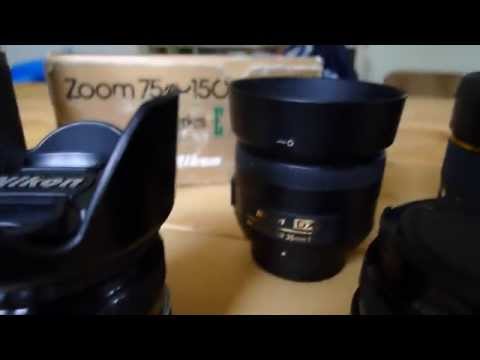

But I found out that it SHOULD bloody work. Here's a girl using non-cpu lenses in SCENE mode (Video mode) - and it works fine:
Will post here as soon as I find out why my D7000 doesn't want to film with my beautiful old lenses...

The lady in the video above is shooting video in M (Manual) mode, not SCENE mode.
