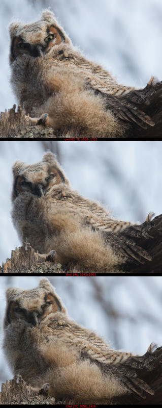

I had a bunch of time with a young Great Horned Owl, so I did an impromptu test. I took several shots and picked the sharpest ones. 300 F4, 420 F5.6 and 600 F8. I cropped the 300mm shot to about 100%, 1558 wide I think, I then roughly matched the image size to the other images. With my particular lens the 2 stop penalty seems to be worth it... direct download.. http://www.mediafire.com/download/qbasms899txjqb8/owl_NO_TC_1558_1321-vert.jpg
It's close. I think based off the images I would say 2x tele > no tele >1.4 tele But really they are all very close, and the advantage of the f4 over the 2x is less distracting background. Your 2x copy is a good one though, thus I can see why you shoot with a 2X all the time.
@manhattenboy, I was actually pretty surprised myself. Although I always thought the 1.4x was the weakest link. The 2x well leaves me 2x the resolution lol. Could make a big difference in print size.. i think the change in the BG was because the wind was blowing and the branches were in different locations....
