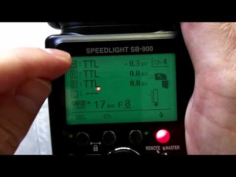

Hello All, Ok, i have a SB900 and a SB910. The SB900 is on remote and I am using the SB910 to trigger the SB900. The SB900 is in Group A Channel 1. Everything works out except I cant stop the SB910 from firing. I've set the master on the SB900 to "-----" bit it still fires. What am i doing wrong? I need your hely

    I believe it has to fire to trigger the SB900 but should not contribute to the exposure. There is quite a few on the forum that use flash a lot that will help you more than me. We can both learn.

    The master will always fire as it has to send the slave information about how and when to fire. But those control flashes should actually happen right before the exposure, so they should not be seen in the image.

    The master flash has to fire to talk to the other flash. That does not mean it is lighting the scene though. The "M" (master) flash needs to be set to "---".
    Easiest way to tell if the master flash light is spilling into the frame is just to turn the head toward the other flash and put a note card taped on the side so nothing spills into the frame to check. A few test shots will tell you.
