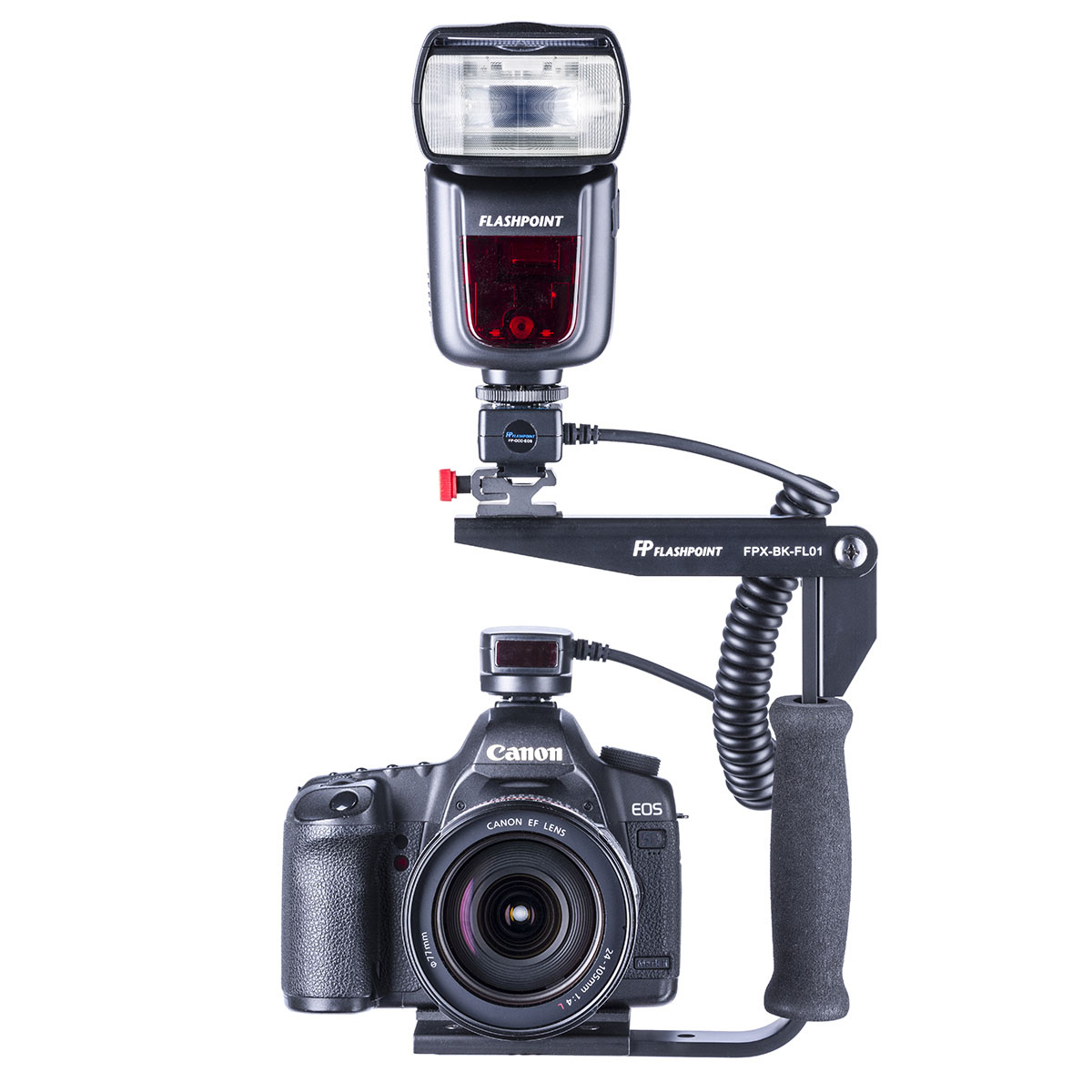

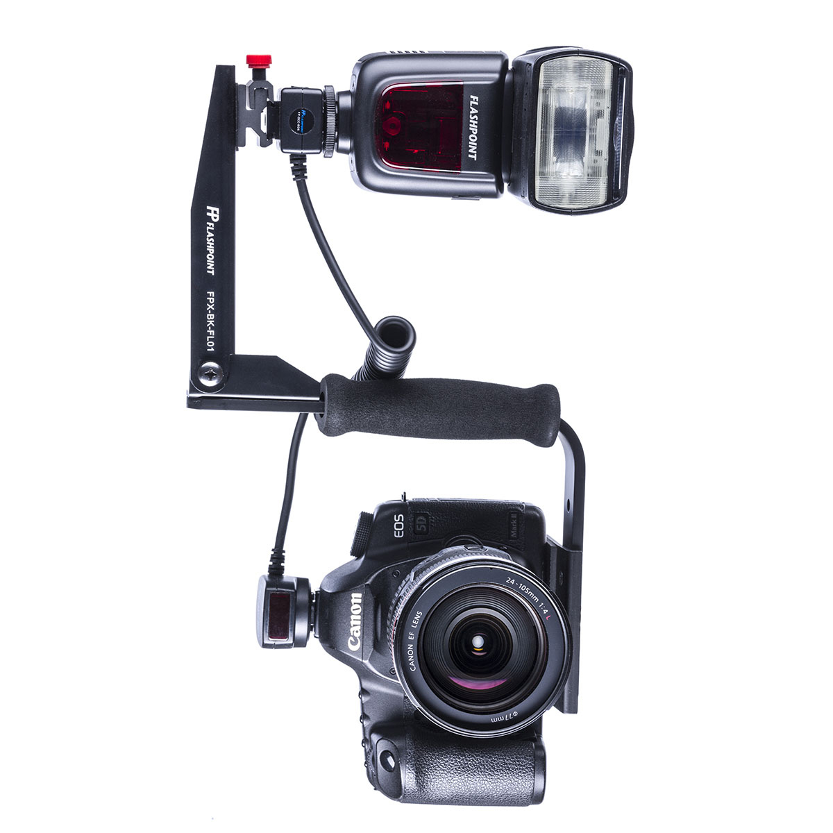

    The purpose of a flash bracket that flips open is to 1) keep the flash over the lens regardless of orientation 2) provide a bit of separation between the flash and camera to reduce harsh/flat lighting look. What @pistnbroke is striving for is not getting too much distance and thereby creating unwanted chin or ear shadows. You can see with a large hammer head flash, and a remote mount, you are starting to get pretty tall:

    Well that flip mount is a bit nasty and I would not use it but the idea is right

    For a flip bracket to work the flash must be EXACTLY over the lens in both landscape and portrait 1/2 inch out and its no good..The photos above indicate that in the lower one for portrait the camera is the wrong way up and the flash is not over the lens centre...useless oh yes and its a Canon
