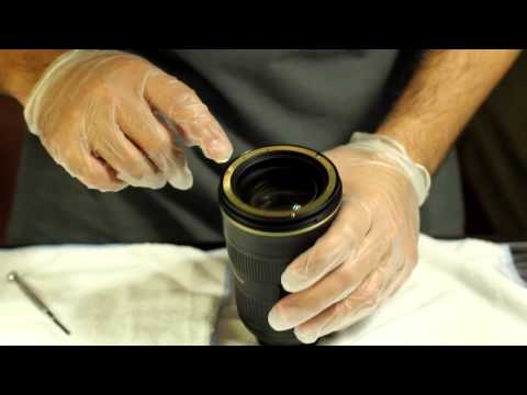

do YOU people open up your lenses and put grease in them? i think i NEVER would

The video was entertaining... and if one does not understand how to assemble a watch, properly, I would suggest not attempting to fix you lens.
A couple of errors in the video...of course, dropping the screws onto the lens surface....inexcusable....this will always leave a residue on the lens surface which should be blown off with the small bulb, examined by very high power magnifier, and if necessary, cleaned...but this is a specialized process. Also, when doing this process, a facial mask should be worn so as to prevent small droplets of moisture from accumulating on the lens surface. Normal talk will produce those and they fly through the air and land on the lens elements.
Then the idea of placing grease inside the lens...You better make certain the correct viscosity, temperature specs and all other factors such as creep are consistent with what Nikon specs for internal lubricant. If not, in a hot storage area such as your car....mmm disaster. There are specific lubricants for the internals and these need to be followed.
The conclusion is that if you are an expert in this, go for it...otherwise....
