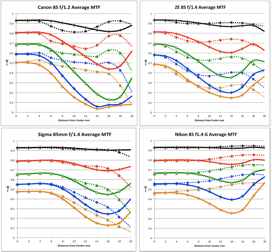

What I have seen of MTF is you cant compare between manufacturers.. maybe lensrental did a review?
This was an argument that LOTS of people made when the 35 Art came out. The Art MTF was way better than Nikon's and everyone called BS. All later tests confirmed what the MTF clearly showed.
This is usually something that people dislike the results of the comparison say. If the focal lengths are the same, for the most part most differences are minor. Remember: manufacturers will generally use a method that makes them look the best.
Just look. The Art lens MTF is a LOT better. It's not even close. I've used both a ton now and I can say that I MUCH prefer the Sigma lens. It's a lot better.
I am sure the sigma is great :-) its just a fact that if you are comparing MTFs you need consistent parameters and methodology. Just have a quick look at this review.. Note the multiple lines of MTF plots depending of input parameters even for a single lense.. The sigma and nikon MTFs have different input parameters. Its consistent within Nikon and within Sigma but you really cant compare them directly.. I am not saying sigma is not good .. My fav lense is a Sigma !
Hearty, I hear what you're saying, but you're still missing the point. There are differences in measurement, but they are SMALL. They absolutely could NOT account for the huge differences seen in the above chart. Differences range from about .1 to about .3. That's HUGE.
Given that MTF ranges from 0 to 1, I'd say that's a 20% difference. What we don't know (and what I can't seem to find out anywhere) is how many line pairs sigma uses to produce those two lines. Nikon uses 10 and 30, clearly stated on the graph legend. If sigma uses 15 and 40 it would easily account for the difference. Has there been any head to head reviews of these 85s?
When Rodger reviewed the previous sigma 85 the Nikon was king, but his MTF for the 85 looked better, and again here we know the line pair counts (10, 20, 30, 40, etc...)

@Ironheart -- The DxO scores of the original Sigma and the 1.4g are actually very close (38 vs 40). I don't know what you are looking at, but to me the MTF above for the Sigma is worse than the MTF for the Nikon; indeed, much worse. And yet in the end only a 2 point difference from DxO.
I'm afraid you've just undermined your own argument.
@PeachBlack Not sure I was arguing for anything, other than making sure we have the proper information to make an informed decision. Roger puts the lenses (and usually a bunch of copies) on his own optical bench to run his own MTF charts.
DxO is only looking at the center of the image where the (older) Sigma was strongest.
Don't get me wrong, I think Sigma makes a great product, and it's great to have the competition for both Nikon and Canon as it keeps them on their toes.
@Ironheart - Sure thing. The argument that's often made, though, is that "MTF charts are meaningless." I argued that while in theory this was true, history shows that in the case of Nikon vs. Sigma, they are not.
The MTF of the 35 Art was much better than the Nikon 35 and everyone was saying MTF charts are meaningless. Subsequent evidence has shown that the MTF charts were right.
Likewise, the MTF charts above showed that the 85/1.4 of the original sigma should be a little worse than the Nikon, and subsequent evidence has borne this out.
So rather than saying "MTF charts are meaningless," a more rational approach would be to see how synchronous previous Nikon and Sigma MTF charts have been. It seems to me that there are no wild differences in the way they measure things.
So, if I were a betting man (I'm not), given a comparison of the Nikon 85/1.4g and the Nikon 85/1.4 Art, I'd stake that the Sigma would beat the Nikon by at least 5 points in the DxO tests. And I wouldn't be surprised if that number were closer to 10, which is a ton. And this leaves aside my personal experience with both lenses, which in the case of the 85/1.4g is extremely extensive. To me there is no contest, the Sigma is a *much* better bowling ball... umm, lens.
https://www.lensrentals.com/blog/2017/01/third-party-ultra-wide-lenses-mtf-comparison/
https://www.lensrentals.com/blog/2014/09/just-the-lenses-canon-and-nikon-mount-85mm-f1-4-and-1-2-primes/
