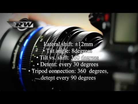

    Simply the best if you could get one and of course your credit card could stand the cost.
    https://www.schneideroptics.com/ecommerce/CatalogItemDetail.aspx?CID=1822&IID=10247
    Post edited by paulr on
    Yeah, I have been drooling over this for over a year now. My only complaint is that I am not sure if 28mm is wide enough. It will be fine for exterior shots I think, but I find even 24 not quite wide enough for some interiors. I heard a rumour the Schneider might come out with a 20, which I might find more useful.

    WestEndFoto When I was at the Photographic Show {Ex Focus} I went to the Schneider stand to look at the new lens 28PCTS, They were very reluctant to show me the lens, i explained I had the 90 version so the rep went to a SAFE and brought me the lens , The whole time two security guards stood next to me, Apparently this was the only 28mm version in Europe, Thats why I said if you could get One regardless of cost. I quizzed them on other future productions but no mention of a 20mm PC lens, It took them 5 years to perfect the 28mm version.
