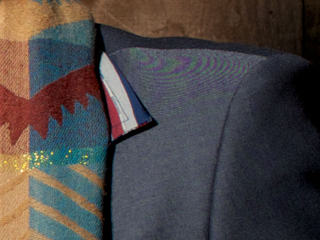

    Before Capture NX2's moire removal, false color artifacts were clearly visible on the fashion designer's left shoulder, and to a lesser extent near his suit pocket + left arm.
    Shoulder at 100%
    Pocket + Left Arm at 100%
    I use Aperture (which doesn't have good moire control) so for this one frame the workflow was:
    NEF -> Capture NX2 -> TIFF -> Aperture -> JPG
    When zooming to 100%, Capture NX2 removed virtually all of the false colors from the shoulder area but the result wasn't perfect. However at normal zoom levels it looks just fine.
    There was actually no sensor moire on the scarfs at all. Any artifacts seen were introduced when Aperture downsized the image from 36mp to a web-sized JPG.

    OK, well that was interesting. The moire is present at high magnifications and the effect seems to reduce/go away at smaller sizes on my (decent) screen. Look at the guy on the rights jacket shoulder and cuff for the most moire.
    I used the brush in LR4 in an attempt to remove the moire, but find that it does not remove moire, it apparently just seems to alter the colour patterning towards B&W (on this image anyway) other instances of moire on different materials may differ. The slider starts at a centre zero position (I can't think why one would want to add colour to moire by sliding it to the left), and sliding to the right reduces/alters the colour leaving the pattern. I deliberately brushed over the guys lapel and scarf slightly and it is plain to see the colour has been altered where there is no moire.

    Thanks spraynpray, interesting comparison!
    I think we're seeing the two aspects of aliasing: 1) false color artifacts; 2) the moire pattern. Looks like LR did a great job with the false color correction. I think the pattern itself is best removed in Photoshop if needed be, but since we don't usually see images at 100% zoom the slider controls are probably sufficient most of the time.
