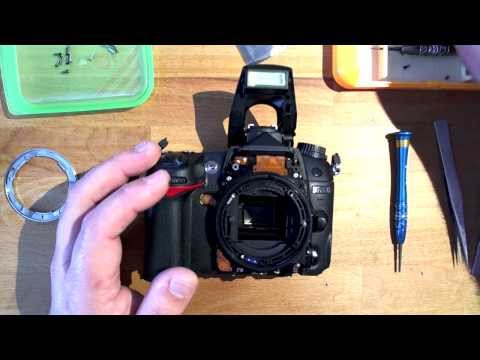

This issue is probably resolved by now - but for the record od benefit of others I'll still chip in with my comment. I had the same issue on my Nikon D750. I checked the contacts, made sure that lenses (as I had this with more than one lens) is locked on highest aperture. I even changed the mode from command to focus ring (helped a bit, but I did not have full functionality). So I took it to Nikon to be fixed. There is a small ceramic part inside that is called "Aperture F-FO Base Plate Unit". It is fragile and easy to break. It can break from normal use, possible vibration going over speed bumps or if you knock your camera. In my case Nikon fixed it for me under warranty free of charge. If they diagnose it as mechanical damage, they might refuse though - in such case (or if camera is out of warranty) you may purchase the part on ebay (make sure you purchase right part) and take it to local camera shop to be fixed. If you know what you are doing (I didn't) you can do it yourself - in the video below instructions for D7000
