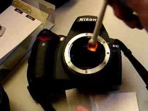

3) Am I comfortable cleaning my own sensor and to what degree?
Oil spots need to be wet cleaned. This can be an issue when the camera is new (my D800 had a few oil spots). Wet cleaning with a sensor swab can be frustrating and take several tries to get right. It's worth having professionally done in my opinion. Especially under warranty.
Dust is able to be removed dry. First use a good blower (in a clean area) and see how it goes. For the stubborn spots use a sensor brush (I replace mine every year and keep it in a plastic bag). Just broom off the dust and you're done. No wet streaks or residue that an improper wet clean leaves behind. It's actually quite easy.
People think the filter/sensor that they're cleaning is like a delicate flower but it's not. It's about as hard as soft glass so be careful but it's not like anything that touches it will scratch the surface. I would bet that it's tougher than the coatings on your front lenses.

Pentax sensor stick.
