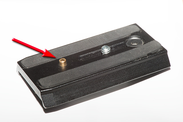

Most quick release systems (including the Giottos listed) are better suited for camcorders than for DSLRs, in my opinion. They use an anti-rotation pin to prevent the camera from twisting on the QR plate:
(anti-rotation pin on a video QR plate)
However, most DSLRs (Nikons at least) do not have the matching "hole" to accommodate this pin. As a result, you have to really tighten the tripod screw (not a great idea) to prevent twisting by using friction only. Not a great situation when you have to shoot verticals with heavy lenses.
You'll also notice that the quick release plate shown with the "Sliding Quick Release" has the wrong shape for DSLRs. Camcorders are long (front-to-back) whereas DSLRs are wide (side-to-side):
(a sliding QR plate may have the wrong shape / direction for DSLRs)
The Arca-Swiss system, in contrast, typically use custom plates each shaped to fit a particular camera body or lens model. So even in the absence of the anti-rotation pin, the Arca-Swiss plate will not twist by virtue of its tailored shape. This is one reason why they are popular with photographers. The downside is you have to buy a plate specific for your camera (or lens) model to benefit from this arrangement.
Some ball-heads have removable/replaceable QR systems, but most don't.

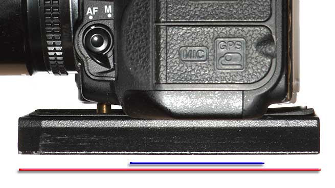

Mounting the plate "sideways" may work but defeats the purpose of having a long sliding plate & head to begin with. The plate is long so it can be moved "forwards" or "backwards" on the tripod head to compensate for different lens weights / CGs. E.g., mounting a heavier lens shifts the centre-of-gravity "forward", so you can compensate by sliding the plate backwards to keep the CG optimally positioned on top of the head.
This feature only works if the plate is mounted correctly, with the long side along the axis of the lens. Otherwise don't bother getting a sliding QR (which is more expensive). Get the regular QR system instead and save the money.
Another issue with mounting the plate sideways is that many heads & accessories are directional and expect the camera to be pointed "forward". Otherwise the knobs/dials/buttons will be ergonomically in the wrong position. E.g., if you attach a panning handle, the handle will now be "out of position" and sticks out to the side instead of towards the operator, because the camera has been rotated 90 degrees.

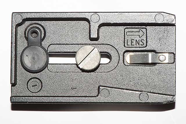

The QR head syn3rgy linked to is called a Sliding Quick Release head for a reason: the plate can slide!
In a proper sliding QR head, there are two safety catches on the slot (one in the "front" and one on the "back"). This allows the plate to float about two inches on the head (between the two safety catches), before the friction lock is engaged.
When you look at the long plate, just the position of the anti-rotation pin gives a clue on how the plate should be mounted. (Hint: not sideways!) On most plates, if you flip the plate over there is also an arrow clearly showing the correct lens direction:
(Point the lens in this direction, please!)
If that's not clear enough, here again is the link syn3rgy provided for the sliding QR head:
There is a "Video Feature" on the right hand side of the page. Go to 0:57. Here's the transcript:
"Model MH1300-621 features a sliding plate, that allows you to counterbalance the weight of your camera and lens, before adjusting the friction control."
The video clearly shows the camera on its plate being slid front-and-back, to optimally position the CG on top of the head.
This is the "reason to be" for the long plate. Otherwise, just use a short plate. And no, don't depend solely on "friction" to keep the camera twisting on the plate. That's a very bad idea! When using heavy lenses, with just friction the mounting screw has to be so tight that countless people end up stripping the socket thread.
http://www.giottos-tripods.co.uk/index.php?page=productpage&cat=49130e8d88135&product=518a6639e786f
Yes I'm sure there are many photographers who are incorrectly mounting their plates "sideways", but really they should know better!

If the place gets mounted onto the camera Vertically to the base of the camera instead of horizontally to the camera base, how much would it "jut out" at the back and front of the camera body? if you get what i am trying to say.
Unless i am missing the point here
It's hard to see from the pictures, but they are NOT actually using a Giottos sliding plate like the one on the head you posted earlier. Instead, they are using a Wimberley P-5 plate which is designed for SLRs. The P-5 does not have an "anti-rotation" pin and is meant to be mounted "sideways".
BUT, the HEAD they are using is designed to work with the square (short) plate, not a longer plate.
To use the P-5 plate, they had to modify the head by removing the single safety catch. Bad idea!!
Then they complained that when the head is turned vertical, the longer plate now bangs against the tripod (d'oh!) So they suggest shifting the camera off-center when shooting verticals.
At this point, one should ask: Why? Why? Why??!!
If they just got the right QR head and plate to begin with, then they didn't have to modify the head to remove the safety catch. They didn't have to buy another plate to replace the one that already came with the head. They didn't have to fiddle with the camera placement to prevent things banging against the tripod.
Looks like they're actually selling this stuff. I don't think they're giving great advice to their customers.
That head (MH 1302-655) is actually an Arca-Swiss compatible head, so had they simply used the correct camera plate they could have avoided all the problems.
To your question, how much would a sliding plate "jut out" when mounted correctly on a SLR, see the second picture I posted above (the one with purple and red lines).
